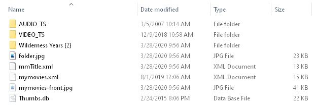

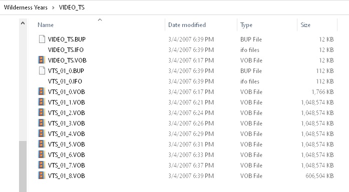

Can you post a screenshot of the "W:\Wilderness Years" folder contents?
Re: Trouble playing VOB files
Two screenshots are attached.
- Wilderness Years 1.jpg (30.67 KiB) Viewed 14815 times
- Wilderness Years 2.jpg (63.72 KiB) Viewed 14815 times
Excellent, thanks. All your data looks pristine, so no problem there.
