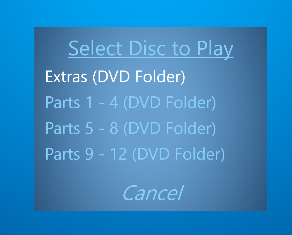

We are talking about the same thing. This already works in MM Browser, see:
The reason this is not working for you is explained in my previous post: you must use the same file paths My Movies and for MM Browser.
In your screenshot, I can see the 'Location' is '\\psf\Home\Movies\'. This must be the same value you enter into MM Browser for folder scanning.
If they do not match, you will not see the disc names, but will instead see the file names.
Paul
