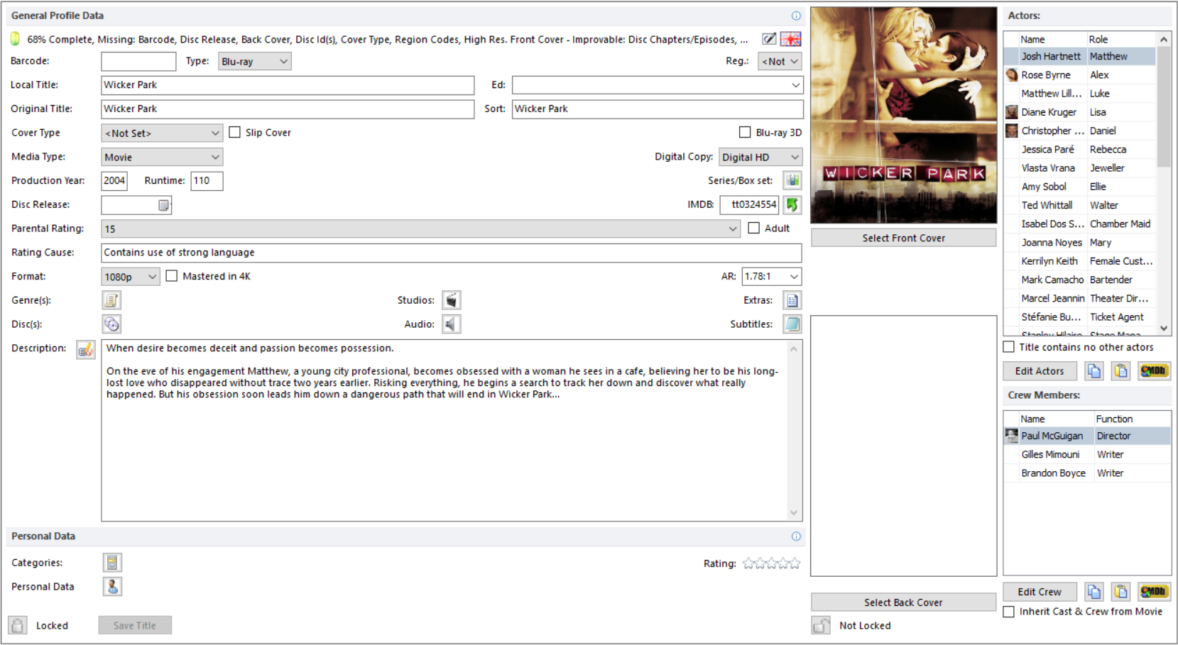

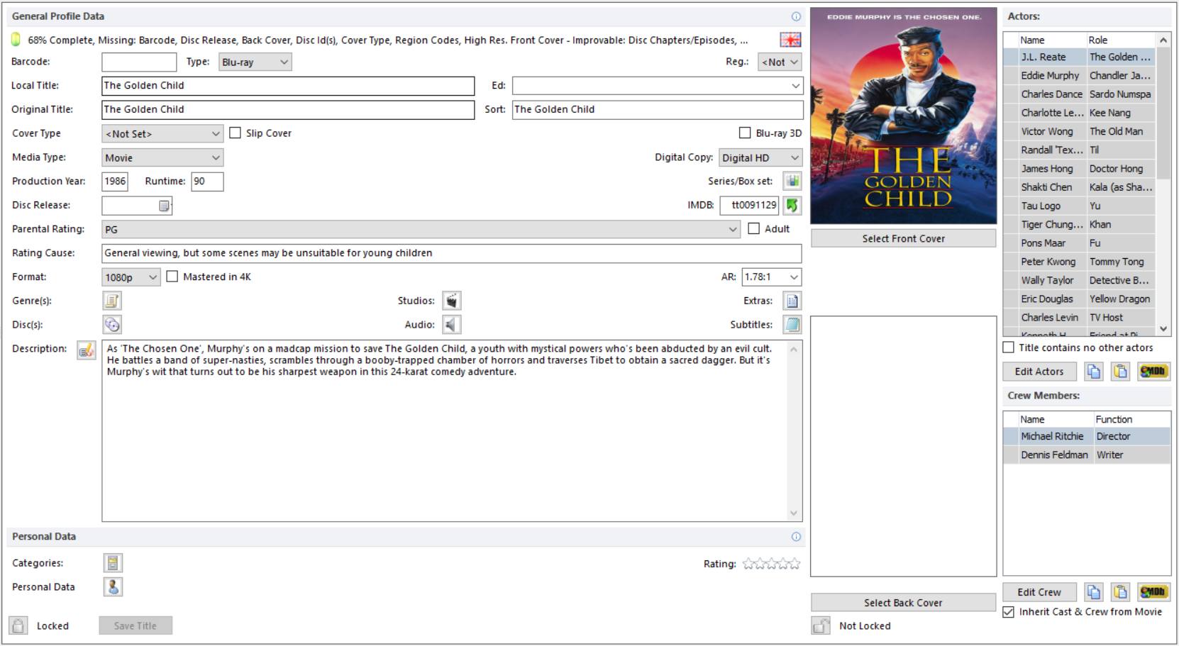

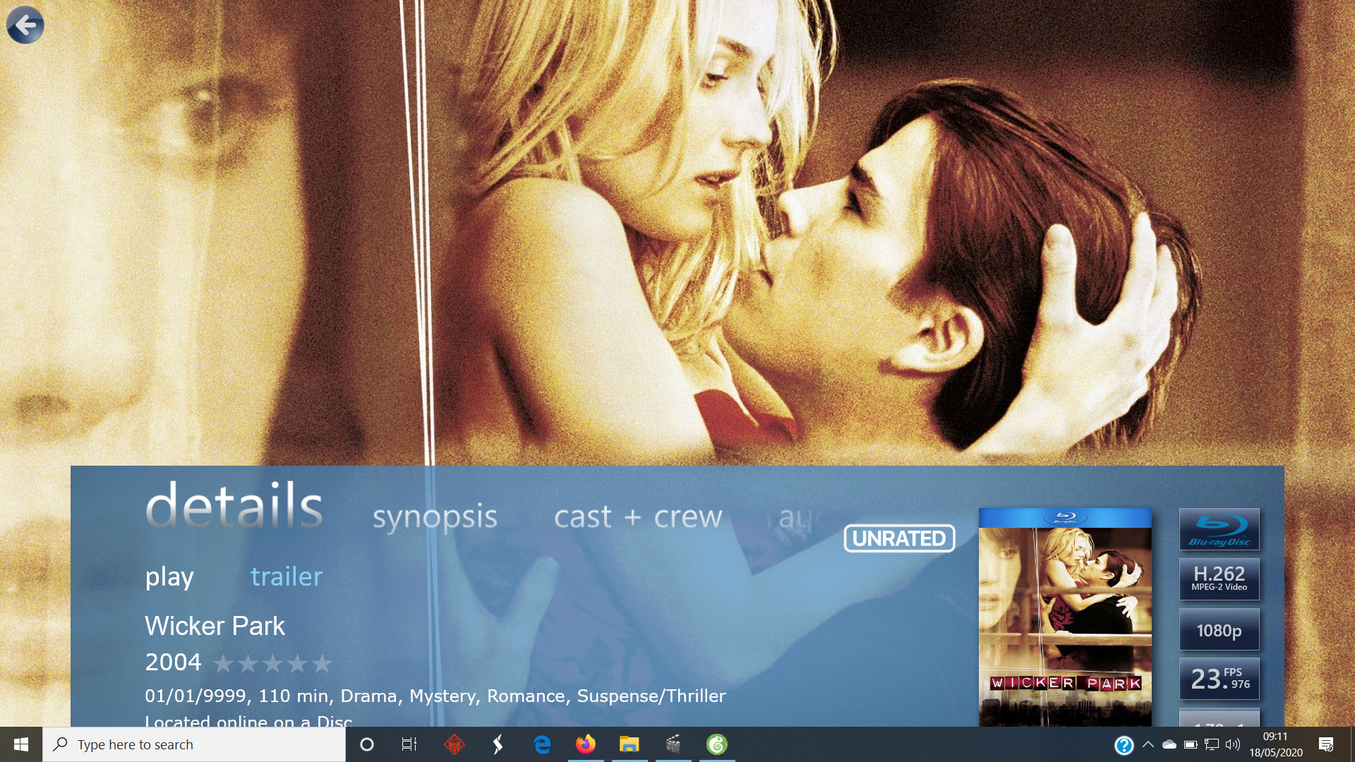

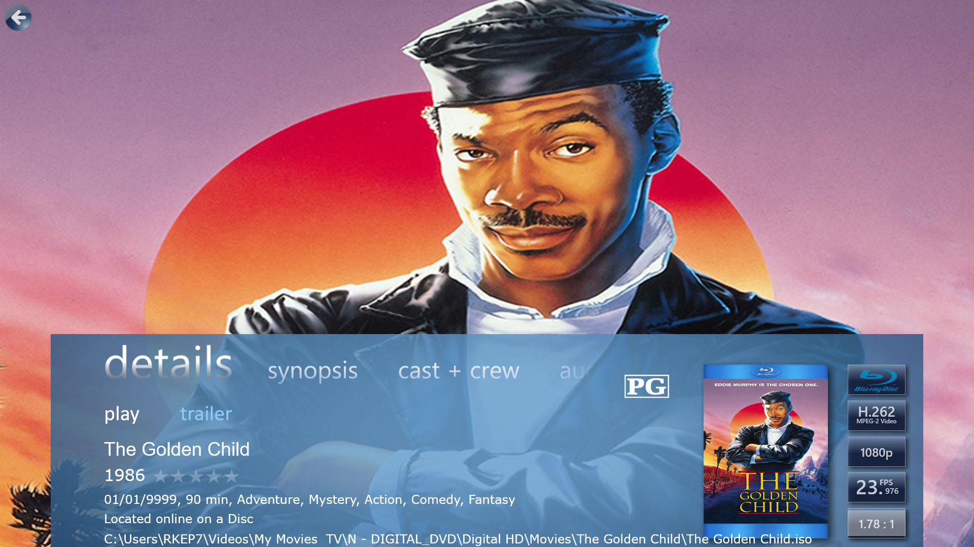

Hi Paul
Please find attached. As you can see both titles are UK, Wicker Park is a 12 and is displayed as unrated as America dosent have a 12 cert. The Golden Child is PG and is displayed as America does have a PG cert. Thx

I checked it out, and it seems my memory has failed me a bit. While I did add some support for international ratings, I hadn't made it as far as I thought. CMC correctly determines the international rating for this movie, but then fails to find a corresponding US rating image to show for it. When this happens, CMC defaults to showing Unrated.
I'm going to put this as the highest priority for the next release. I knew I still had to add the international rating images, but I didn't realize this was so badly broken.

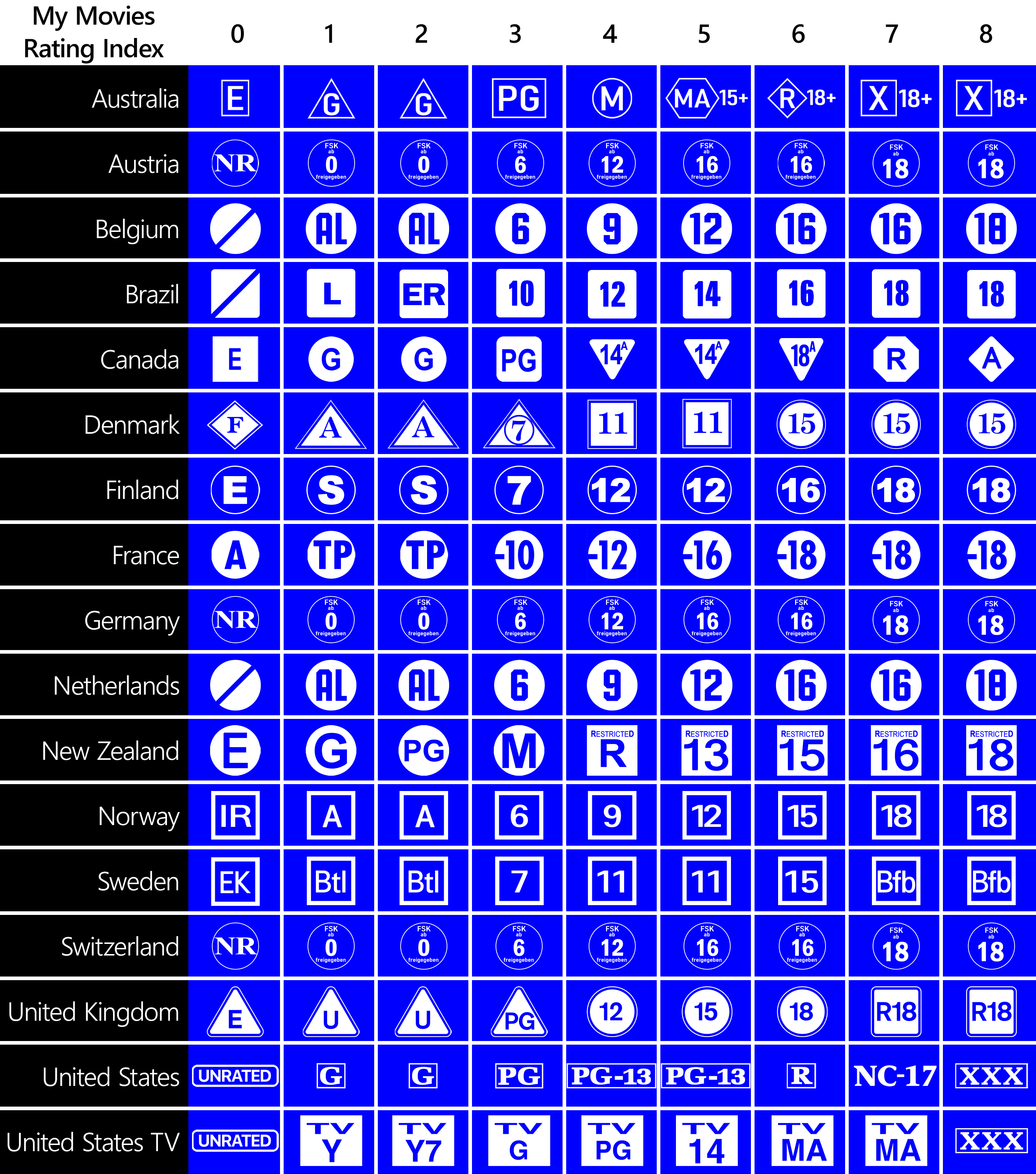

I've added the United Kingdom rating icons to the next version of CMC:
Actually, I went a step further, and I've added all of the rating icons for all regions supported in My Movies. This was a lot of work, but I think it is worth it. About half the icons I had to recreate from scratch, as I couldn't find high enough resolutions online. And some countries, like Sweden, don't even have icons, so I made them up as needed.
Below is a grid showing all the rating icons for CMC. Note that the columns are according to the internal "Rating ID" index values in My Movies Collection Management, so there are a few oddly ordered icons like the New Zealand 'R', but that is a Binnerup design choice, not mine.
I also find it interesting how much variance there is from country to country. Movies watched by 9 year old children in Belgium, the Netherlands and Norway are rated for 14 year-olds in Canada. Though perhaps Binnerup's rating index doesn't always accurately convert from one country to another.
If anyone sees any incorrect icons, please let me know.
