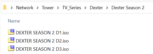

Yesterday I was watching Dexter Season 2 which I have on ISO. Earlier in the day I had watched episode 1, and the ISO mounted fine. Afterwards I had performed a SmartSync, and then later tried to watch episode 2, and the ISO would not mount with Virtual CloneDrive. Troubleshooting the issue, I finally discovered that the Disc Location in CMC was pointing to an Online (Folder) (\\Tower\TV_Series\Dexter\Dexter Season 2\), which happens to have all 3 of the Season 2 disc ISO's in the same folder, and CMC was trying to mount the folder itself as an ISO, instead of mounting a specific ISO file. Obviously, VCD can't mount folders, only ISO files.
I did a Full Sync and the problem was resolved... temporarily. CMC now had the full path to the ISO (\\Tower\TV_Series\Dexter\Dexter Season 2\DEXTER SEASON 2 D1.iso). But any xml metadata updates that cause the SmartSync to process this title again brings the problem back. This is because I have Disc 1 Location configured as an Online (Folder) in MMCM, and Discs 2 & 3 as Online (File) pointing at their respective ISO disc files. When CMC's SmartSync processes the update, it is overwriting the previous Disc 1 ISO file path (that CMC discovered during the Full Sync) with the current Online (Folder) path in the XML metadata.

The problem, then, is what do I do in a directory such as the Dexter Season 2 screenshot above, where I have 3 ISO's residing in the same folder? I could grab the first ISO filename alphabetically, and that might work most of the time, but there is still a potential issue with this approach.

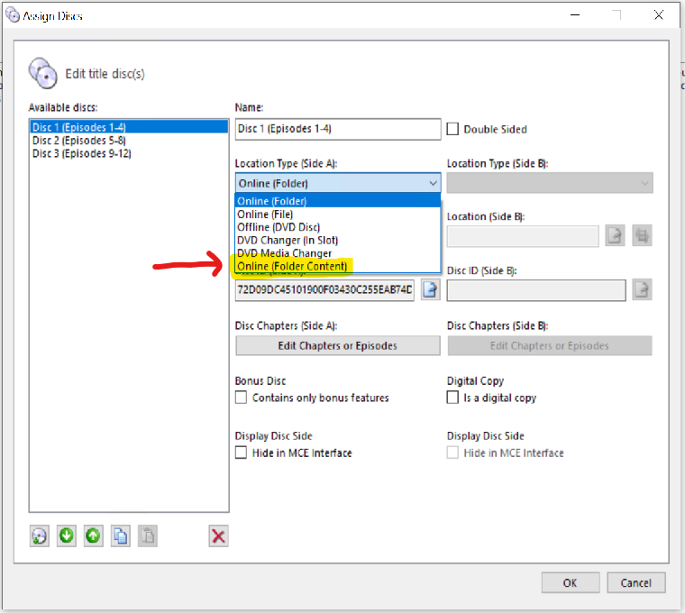

Along the lines of that last question, I have this concern: There is another Location option in MMCM for discs, "Online (Folder Content)". I've never actually used this option, but it's been in the back of my mind ever since I read a post by Binnerup regarding "Online (Folder Content)" being the solution for an Online Folder that has multiple media files in it:
Perhaps that is how I should have configured my Dexter Season 2. Does anyone here ever use "Online (Folder Content)"? I'm guessing no, because I think CMC would break in this scenario, but since I haven't tried it myself I really don't know.

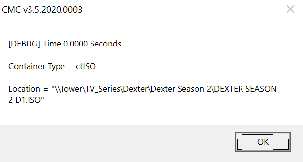

This morning I've written a "Disc Location Validator", probably something that should have been there all along. I tested it on my Dexter Season 2 Disc 1 that was pointing to the parent folder instead of the ISO file, and it fixed it:
PlayClick Debug Log Generated 6/28/2020 12:43:53 PM with CMC v3.5.2020.0003
 *** BEGIN OF PLAYCLICK DEBUG LOG ***
Season 2, Episode 3
MPLS 00002, Title Number , Chapter Number , ISO Episode=True
Validating Disc Location
  Scanning Folder:  \\Tower\TV_Series\Dexter\Dexter Season 2
    Found ISO, checking to see if assigned to another Disc:  DEXTER SEASON 2 D1.ISO
      ISO not in use, selecting for playback
Player=MPCBE
A Disc is currently mounted, checking if it is the right disc...
Red Fox Processing Complete Verified
Player Commandline= "V:\BDMV\PLAYLIST\00002.mpls" /fullscreen /play /close
Starten 'Media Player Classic'
 *** END OF PLAYCLICK DEBUG LOG ***
It was surprisingly quick, taking 0 seconds, so my performance concern was unfounded:
