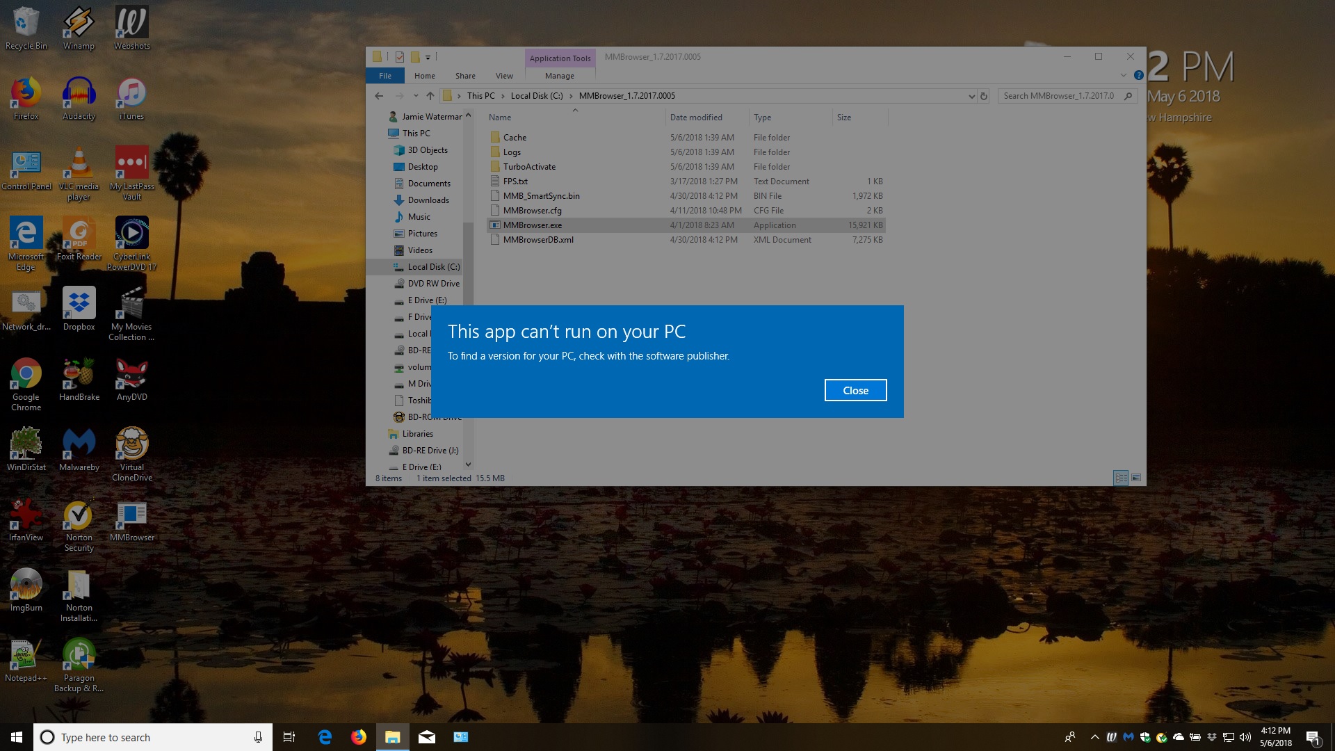

MMBrowser refuses to play nice on a clean install of MMBrowser. I get the following issue when I click on the exe.
MMbrowser error.jpg (444.64 KiB) Viewed 19697 times
Re: Windows 10 April 2018 Update 1803
Post by Jamie » Sun May 06, 2018 4:25 pm
