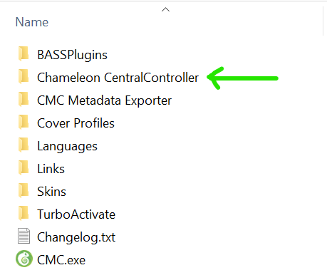

Installing CCC
CCC is included with the downloaded Chameleon MediaCenter zip file, and is located in the Chameleon CentralController subdirectory:
There is no installation required. Once unzipped, CCC is ready to run.

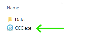

Running CCC
Open the Chameleon CentralController folder and run CCC.exe:
*NOTE: The Data subfolder includes a file named Ratings.xml that is required for CCC to run - do not delete this.

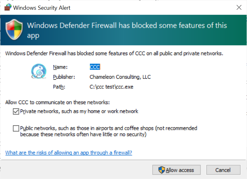

Allow Network Access
The first time you run CCC, you will usually be notified by your Windows firewall that network access is blocked, and you have the opportunity to grant network access. Here's an example:
You should allow access if you are asked, as CCC requires network access, both to read data from My Movies and to send data to CMC. There will be more detail on firewall access requirements, including some manual setup examples, in tutorial 202 - Troubleshooting Connectivity Issues.

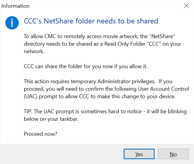

Sharing CCC's "NetShare" Folder
To share exported movie artwork with other CMC PC's, CCC will create and share a new folder named NetShare:
At startup, CCC will check to make sure that the NetShare folder is currently shared on your network, and prompt you to let CCC share it if not already shared:
Usually you will only have to do this the very first time you run CCC, unless you later modify or move your CMC or CCC folder.
When you click Yes, Windows normally displays a User Account Control (UAC) prompt asking you to give CCC the admin privileges required to share the folder. Often, the UAC icon will be blinking on your Windows Taskbar, which looks like this on Windows 10:
Proceed to the next chapter: 104 - Initial CCC Configuration
