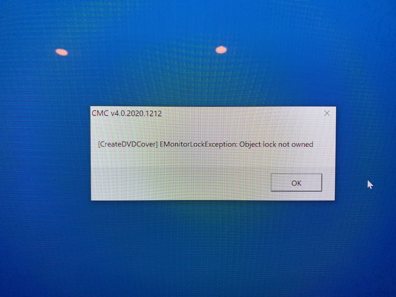

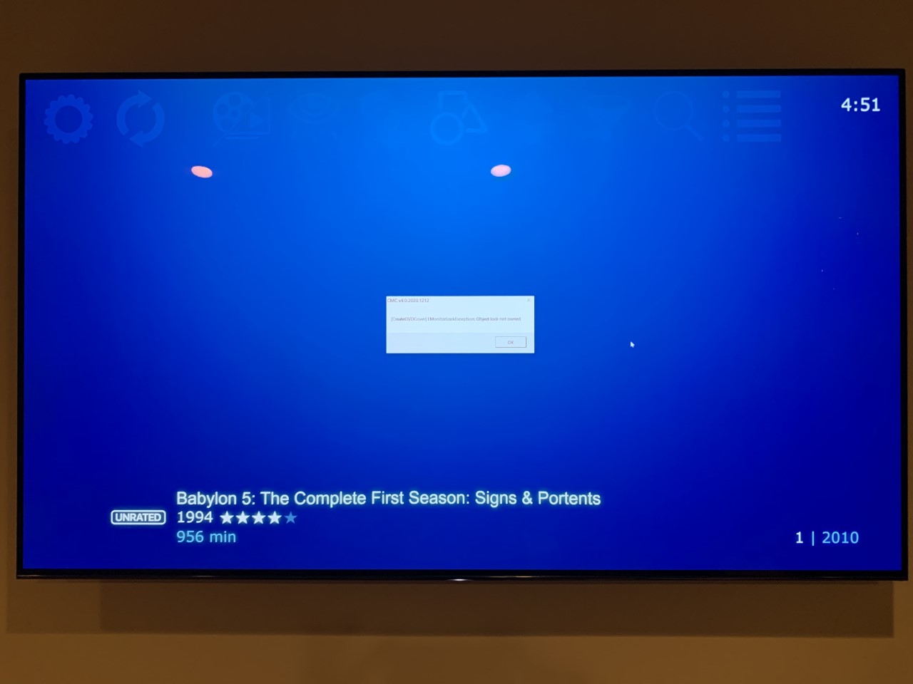

On the other TV I pointed the config to the first TV's IP address, and did a sync. That seemed to work until the next time I restarted the PC. After the restart I get a constant error on CMC, and the library does not work at all. For some reason it wants to drill into the most recent title on start, even though I do not select anything. Then a popup error continually pops up for about 22 times and then I'm left with a blank blue screen. When I try to navigate it thinks I'm scrolling through the titles and I get another 22 error messages each time I use the arrow keys to move around. My second TV is completely broken now.
This is what the error looks like:
Re: Best way to create a home movies series?
Post by Pauven » Wed Dec 23, 2020 8:13 pm
That looks like a file permissions error - your 2nd CMC PC is trying to access the first CMC PC to get artwork, and doesn't have access.

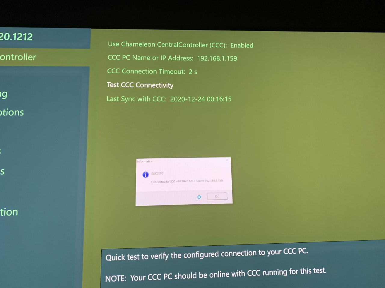

I deleted CMC_MovieDB.bin, but it still gave me the same error when I started CMC. I think what might be happening is that the program is trying to sync with the DB when it starts. After deleting the file I got the same error popup 30 times in a row. I managed to go to the settings and verify connectivity with the first station. See screen shot below when I tested connectivity.
I'm letting it sync again to see what happens. I can see the spinning arrows up in the top even though there is an error popup.

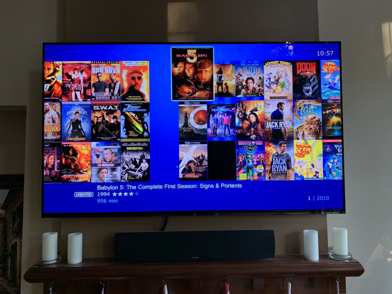

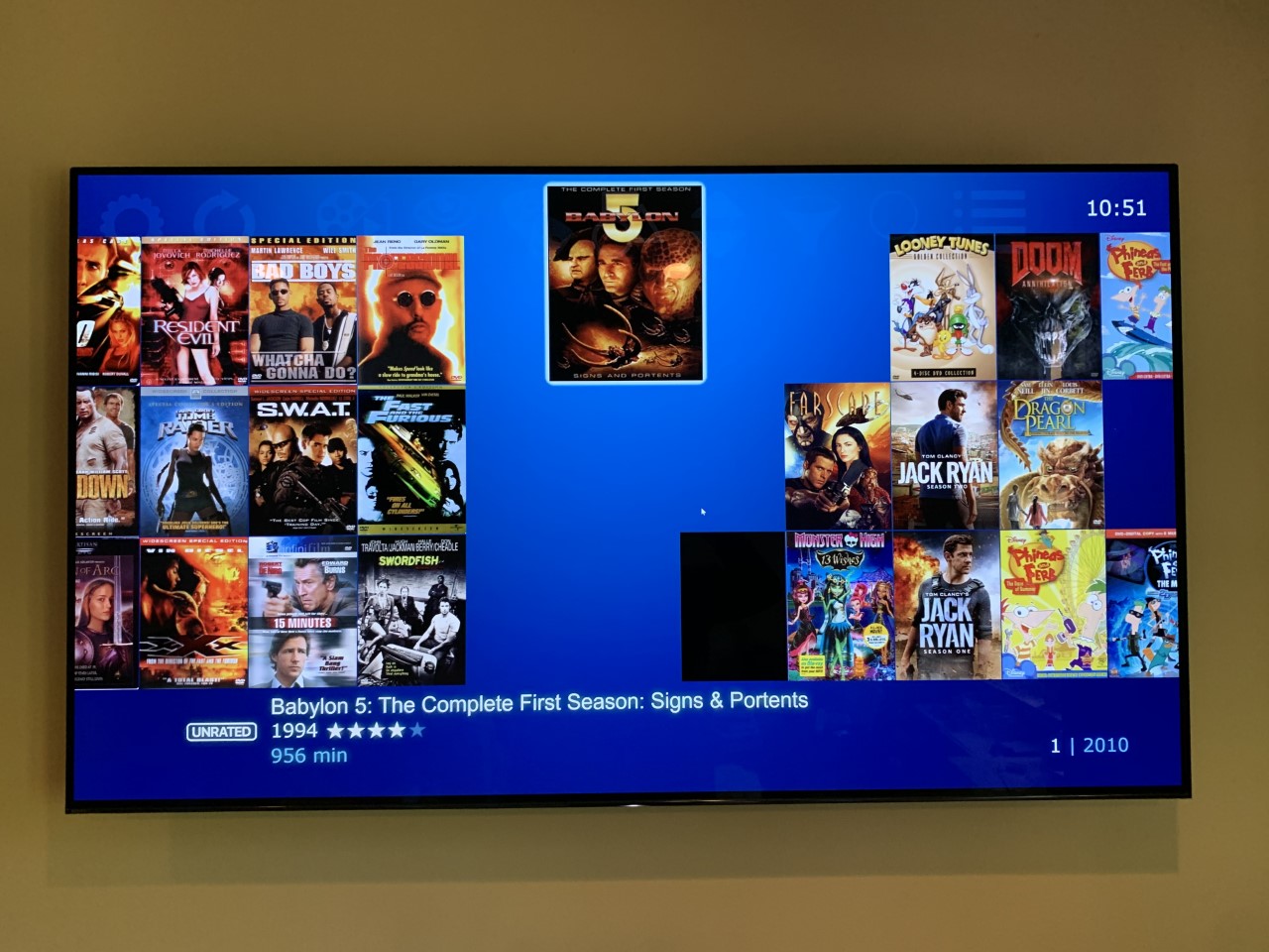

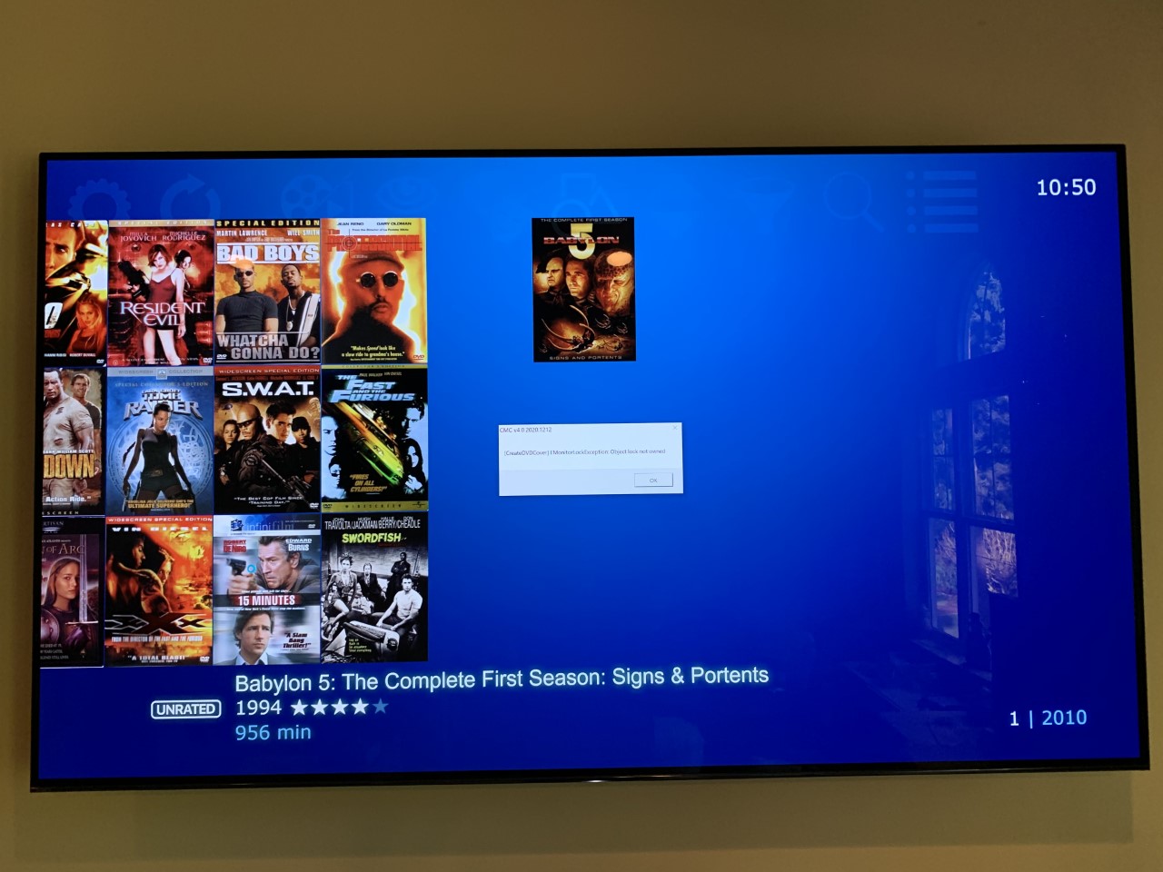

None of those worked, but I found the problem. There was an entry in CMC_ErrorLog.txt that stated the Images folder was missing (C:\Program Files (x86)\Binnerup Consult\My Movies for Windows\Images. My Movie Cover Profile is set to My Movies, but it is not installed on the second machine. I probably uninstalled it a while ago. I was also wondering why I could not get the cover art to look the same as my first PC.
Once I created the folder I started to see icons, but the Blu Ray and UHD covers were missing so I copied the contents from my other PC. Not sure if there are other problems that I might run into with My Movies not installed on the second machine. I prefer the look of the My Movies covers.
This is what it looked like once I created the empty directory, then I went ahead and copied the whole Images folder. The bottom picture is my other PC.
