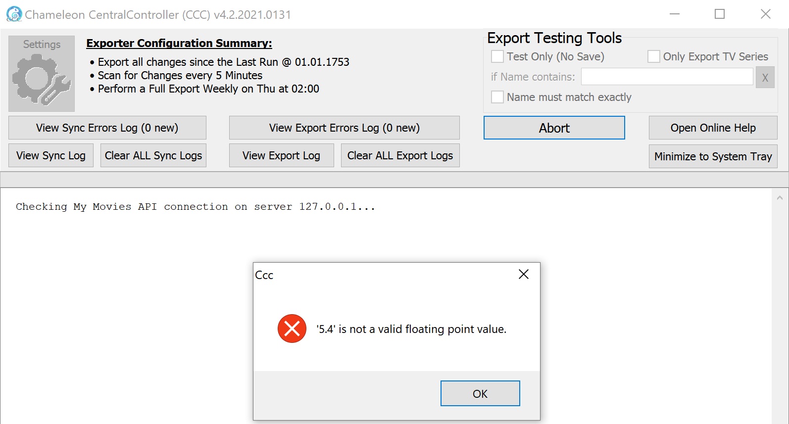

Just installed CCC v4.2 and MyMovies v5.4.
When I try to "Run Full Export Now" I receive the error message '5.4' is not a valid floating point value (?).
Is there maybe an incompatibility between CCC and MM's newest version?

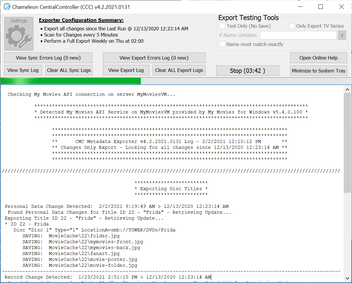

Post by Pauven » Tue Feb 02, 2021 12:13 pm
I just finished upgrading to My Movies v5.4.0.100, and it is working just fine with CCC v4.2.2021.0131:
Is the issue you're encountering repeatable, or was this a 1-time fluke?

I just did some research, and it looks like this error could occur if your PC is configured to use a comma as the decimal separator, instead of a period.
Here in the US, we use a comma to separate thousands, and a period to separate decimals, i.e: 1,000.00.
I've hard-coded (sorry) the String To Float conversion to use a period, so CMC is converting a string with a period, "5.4", to a real floating number. But if your PC is configured to use a comma for the decimal separator, it would need to be "5,4".
Can you confirm this is the issue?
I can make an adjustment in my code to fix this.

Post by ScoobyAS » Wed Feb 03, 2021 3:42 am
Yes, I can confirm. That should be the solution to the riddle.
