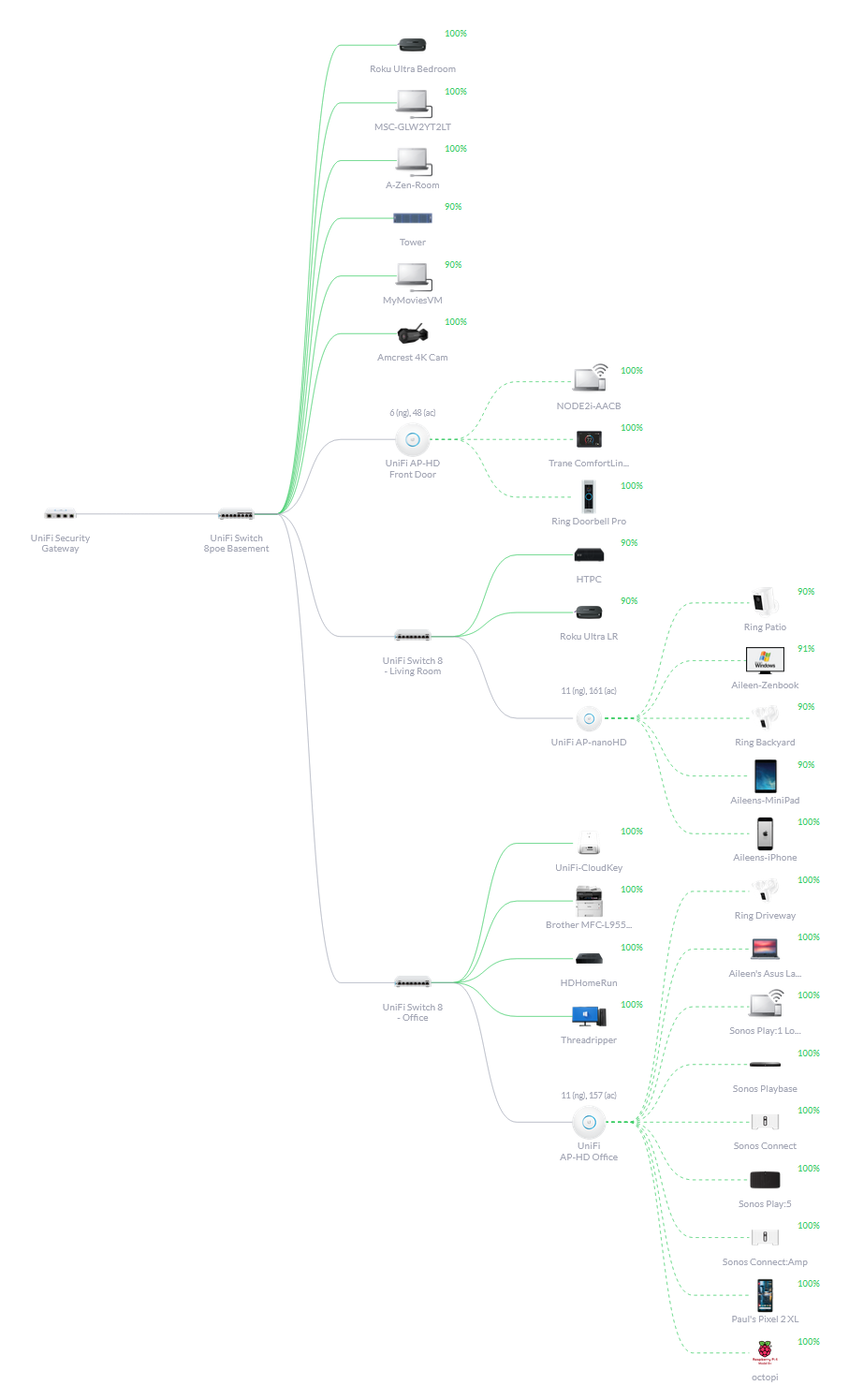

It's hard to visualize how everything is arranged, but it certainly sounds like a mess. One possibility is that the network has multiple paths to get from point A to point B, and the network is looping around inside of itself. Unless you're doing a pro-network with multiple redundant routes that have cost metrics assigned, then you want a very simple network that only has 1 route from any point A to any other point B.
If the above sounds like it might be part of the problem, then I would advise you to sketch out the network so that you can visualize the routes. I use UniFi network gear, and it maps this out for me, so here's mine for example - notice how there's only a single pathway to any one device:
Re: CCC bogs down server when running auto export
Post by Teddyboy » Tue Feb 09, 2021 7:14 pm
Lordy.
He has all his wireless networks on the same channel! He has I think four wireless networks all on channel 6! Geez no wonder it's like this. The radios are fighting one another. I need to put them on other channels, and that should start to resolve the issue. There is a bunch of ATT networks that looks related to the router, but I'm going to ignore that for now and just concentrate on the networks he created. He's going to dump ATT when his contract is up as he doesn't need cable just go with cox internet.
I love UniFi equipment. I actually have brand new Unifi parts in storage that I was going to use when I was renting a house. I may gift it to him and overhaul his network. At least that way I can monitor his network remotely.
First things first. I need to separate the networks to different channels and that should help a lot. Through put was good when they didn't fight. I recall when not having bogging issues as bad as this. I'll put the 2.4 ghz networks on either 1, 6, or 11. The one 5 ghz network on a higher channel. It's recommended 36, 38, 40, 48 to use those. Wifiinfo view is giving channel ranges for each network 4-8. I f I can at least get them off the same channel it has to be better then it is now.
