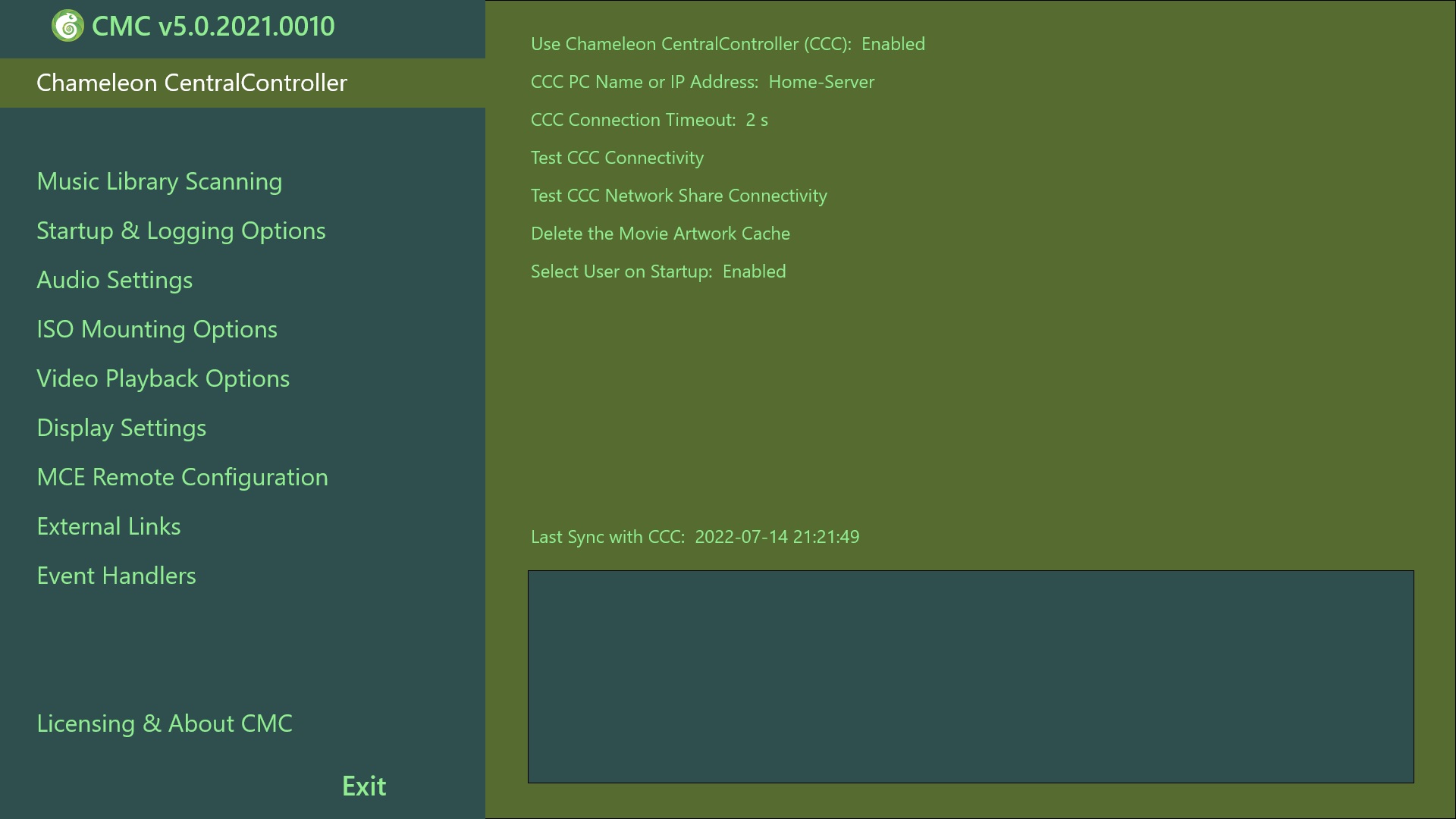

Post by Jamie » Thu Jul 14, 2022 8:49 pm
CCC runs on only one pc preferably your mymovies PC. CMC does not need to be running when running CCC. CCC is the movie import app and CMC is used for playing your movies. You should be able to run the full import of CCC to update all your titles one time and then ask it to update any new movies after the update. CCC should be running all the time on your server. CMC should be updated for each "client" pc to have it point at your server where CCC resides.
Re: Movie library is not populating
Post by Jamie » Thu Jul 14, 2022 9:33 pm
Here's how cmc setup should look for pointing to ccc server. your server name should be different of course
