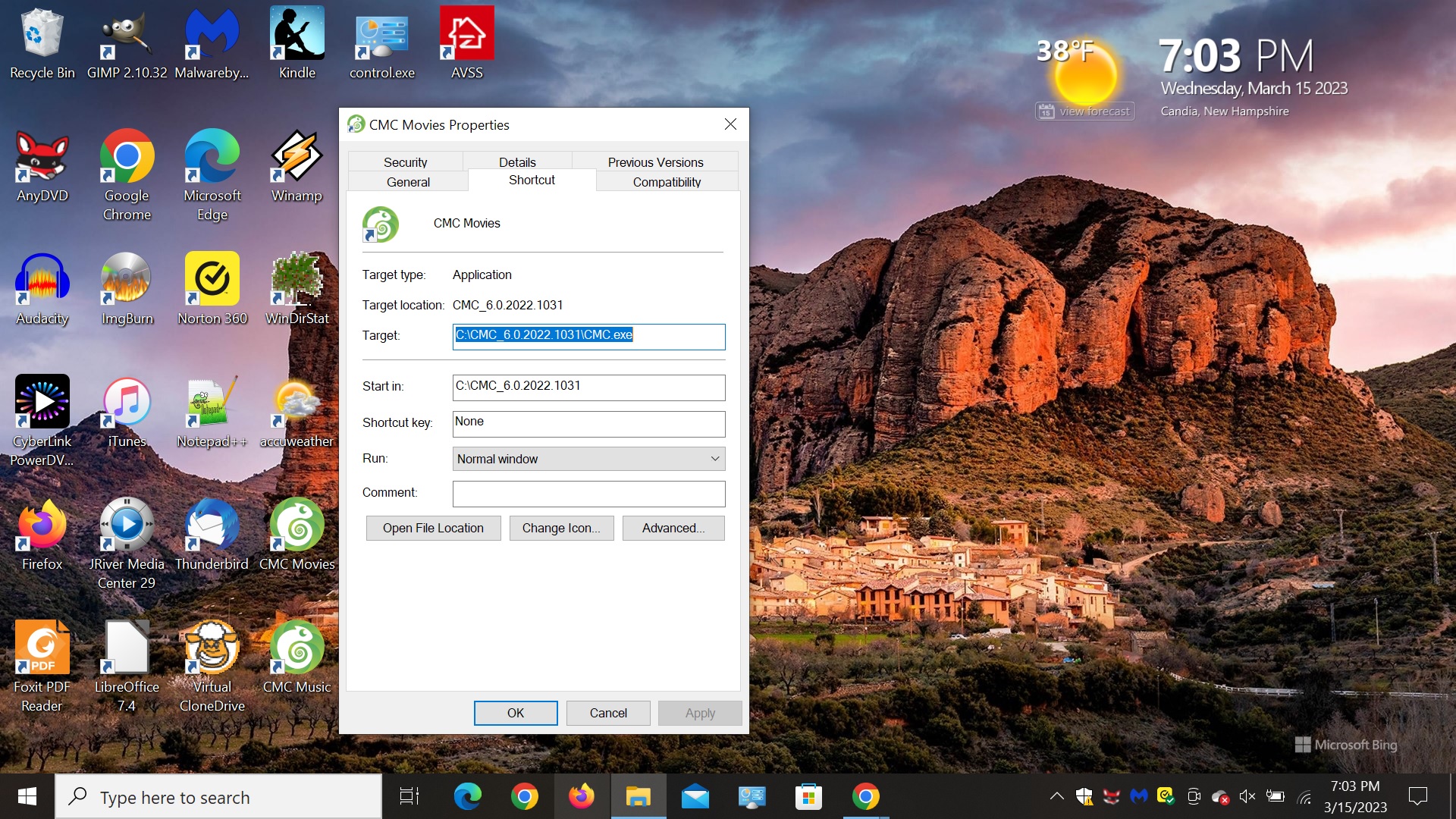

I don't think having the cmc executables on the task bar is the right thing to do. It could create problem in the future. Why not put a cmc short cut on the desk top? All you have to do is right click on the cmc executable in you cmc folder and select create shortcut. Then copy and paste the created shortcut within the cmc folder and place it on the desktop. You can also drag the shortcut file within file exploreer to the desktop. you can also edit your short cuts on the desktop by right clicking the desktop shortcut and selecting properties. See the example below.
short cuts.jpg (750.67 KiB) Viewed 5019 times

Also, notice in Jamie's screenshot that the shortcut is also configured correctly, as it has the "Start In" option populated with his CMC folder's name. Jamie likes to name his CMC folders including the version number, which is helpful for beta testing, but not something I recommend for regular users.
