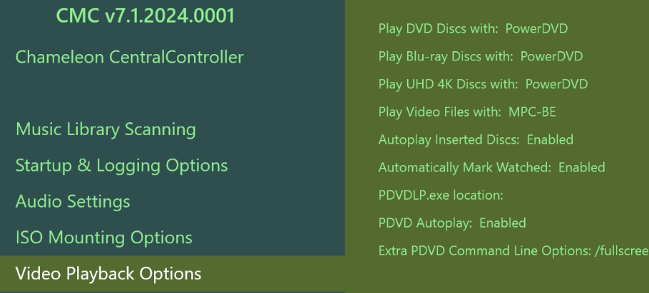

New installation of Windows 10 and CMC 7.1.
Getting errors while starting both movies and trailers, but only from CMC. I have CMC set to playback videos through MPC-BE:

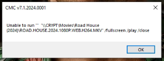

Movie error example:

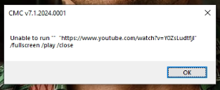

Trailer error example:

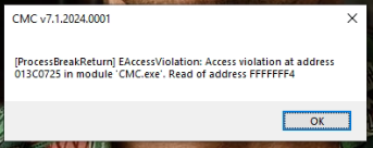

Plus one more CMC error box that came up after another attempt to launch a trailer:

The problem is that the MPC-BE executable was not found.
Please post the path to the MPC executable so I can determine why it wasn't found.

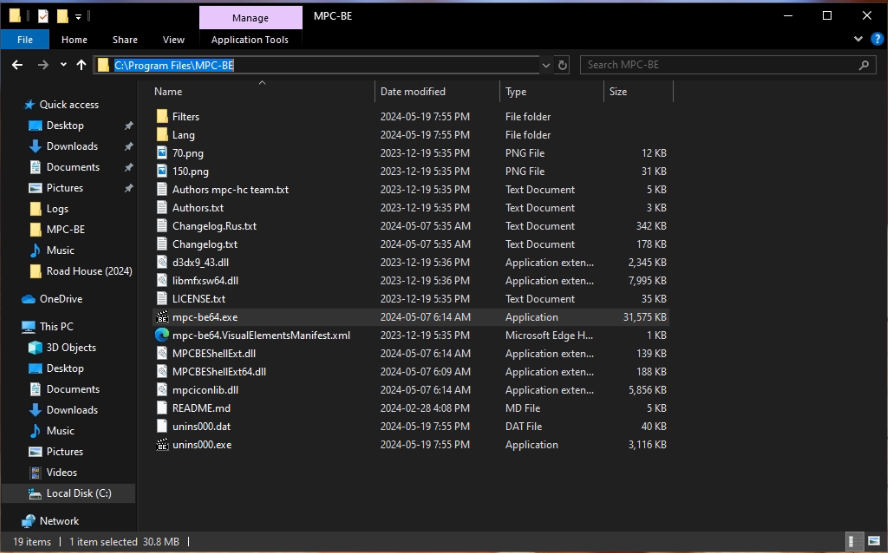

Just a regular installation of the newest MPC-BE.1.7.1.x64.exe with default installation path which seems to be "C:\Program Files\MPC-BE"

I checked, and "C:\Program Files\MPC-BE\mpc-be64.exe" is a combo I've not seen before.
Currently, CMC checks for:
  • "C:\Program Files\MPC-BE x64\mpc-be64.exe"
  • "C:\Program Files\MPC-BE\mpc-be.exe"
  • "C:\Program Files (x86)\MPC-BE\mpc-be.exe"
So CMC looks for mpc-be64.exe, but only inside an MPC-BE x64 folder. And it only looks for mpc-be.exe inside the non-x64 folder.
Since you did the default path, I'm guessing that they've made a change. I've updated the code, and it will be on the next CMC v7.1 Release Candidate.

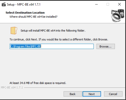

And when I go to install it, the default folder for the 64bit version of MPC-BE is definitely defaulting to C:\Program Files\MPC-BE
I changed the install folder by adding the " x64" to the folder name and all is well with the world now.
The "mpc-be64.exe" file created by the install is indeed found and used by CMC as expected.
