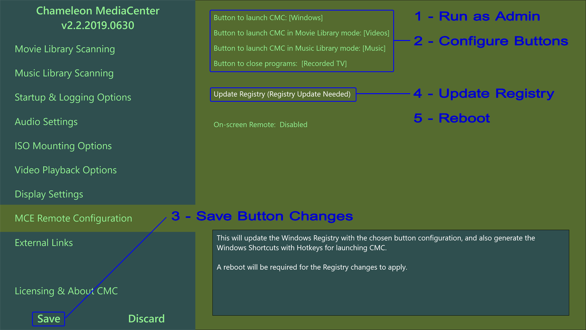

The first thing I do is right click to run CMC as a administrator. I go in and make my adjustments, save, then update registry, and then reboot.
That's exactly how successfully updated the CMC remote settings. I went into CMC as an administrator. Made my adjustments. Saved the changes. The save takes you out of settings, so I went back into the settings and updated the registry. Then I rebooted.
Any way to fix the remotes settings to save the new settings and automatically update the registry in one click? I think that would help a lot.
Re: CMC won't launch from green or any other button
Post by Teddyboy » Thu Sep 05, 2019 8:15 am
Wait! What! I assumed that all I had to do was run it as a administrator, make my button selections, save which I thought was enough to save the changes to the registry, and then reboot to make them stick. I’m confused. Please clarify.
Post by Pauven » Thu Sep 05, 2019 8:38 am
Steps 2 & 3 are optional if you have previously configured/saved the button config you want. Steps 1, 4, and 5 are required to push the config into the Windows Registry and have Windows adopt the changes.
In a few months, when a Windows update resets the registry, just do steps 1, 4, and 5 to get back to a working remote config.

Thanks Paul, but that’s a step that can easily be missed. It’s just text. When it displayed that I thought I just had to save and reboot. I didn’t know that I had to pick it in order to save it to the registry. It needs to be a button that I need to click on in order to apply the button configurations to the registry.
Post by Pauven » Thu Sep 05, 2019 9:19 am
Teddyboy wrote: Thu Sep 05, 2019 9:10 am It needs to be a button that I need to click on in order to apply the button configurations to the registry.
Uhhhmmmm… it is a button that you need to click on in order to apply the button configurations to the registry. But I think I get your point, it wasn't obviously a button to you.
Here's a tip, when on the Settings screen, with two exceptions, everything is a button. The two exceptions? The CMC version info in the top left corner, and the help window in the bottom right. Everything else on the Settings screen is a button.
I'll work on making the MCE Remote Configuration process better in the next version.
Post by Teddyboy » Thu Sep 05, 2019 8:52 pm
Okay! It worked! Finally done with all that drama. Lol. It’s not obvious that I need to click on it to push the changes to the registry. It looks like a line of text. It does indicate that the registry needs to be updated, but I assumed saving would do that, create the short cuts, map the buttons, and create a backup. I think you should only have to click the save button to do all that. The text if left there should just tell you tell click save to commit the changes. Something to think about.

I made the update separate from the save, since every time a major Windows update blows away your config, all you need to do is just update, not save again.
But I get your point, it's not clear. I'll see what I can do.
Re: [Resolved] CMC won't launch from green or any other button
Post by Teddyboy » Fri Sep 06, 2019 9:22 am
Excellent Paul.
If those are the steps you want people to follow, then just make that registry update obvious. Also you really only need one dialog box to state that that the button configurations have been applied to the registry and a backup was created. Make it bigger too. It’s gets a little lost on my 47” 1080P Samsung tv.
