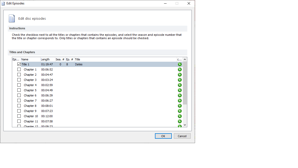

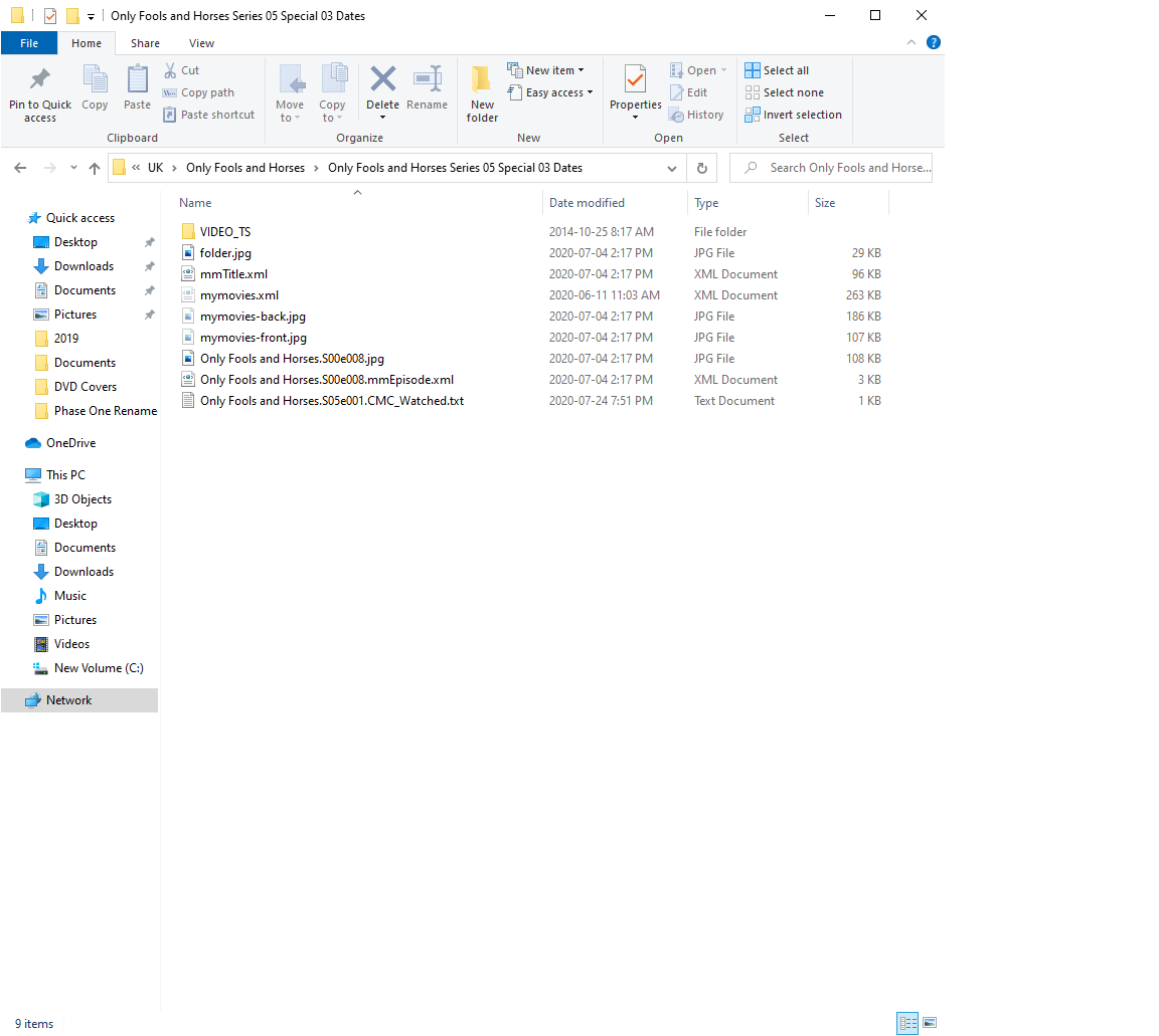

- S00E05 dir.png (61.78 KiB) Viewed 17195 times
- S00E05 map.png (33.14 KiB) Viewed 17195 times
- S00E08 dir.png (61.78 KiB) Viewed 17195 times
- S00E08 map.png (33.53 KiB) Viewed 17195 times

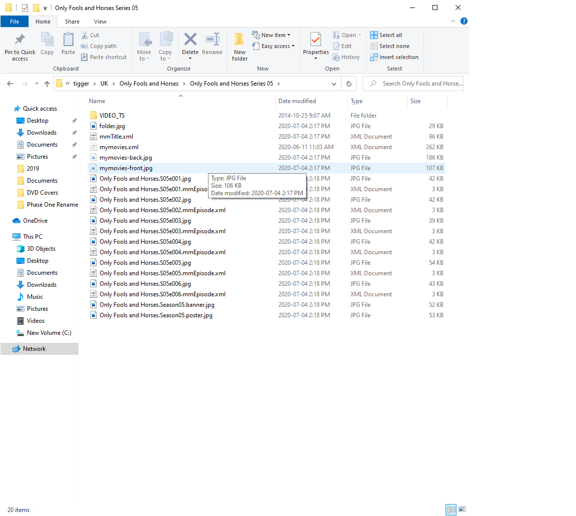

- S04 dir.png (88.74 KiB) Viewed 17195 times
- S05 dir.png (85.93 KiB) Viewed 17195 times

Oh, I guess I wasn't too clear previously that its actually playing the wrong disc (directory) which I think highlights that its not a simple player issue
Re: Interesting TV Series Issue
Since you're having trouble playing S4 E1, I need to see the disc episode mapping for that, not for the Season 0 bonus content. Same with the XML data.

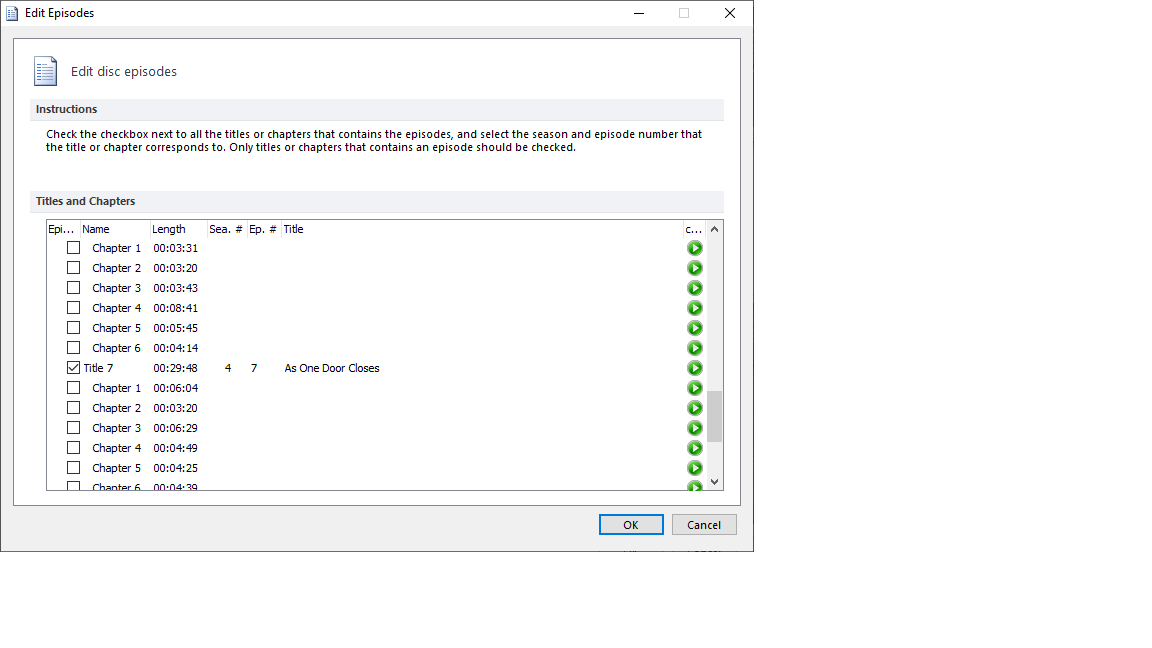

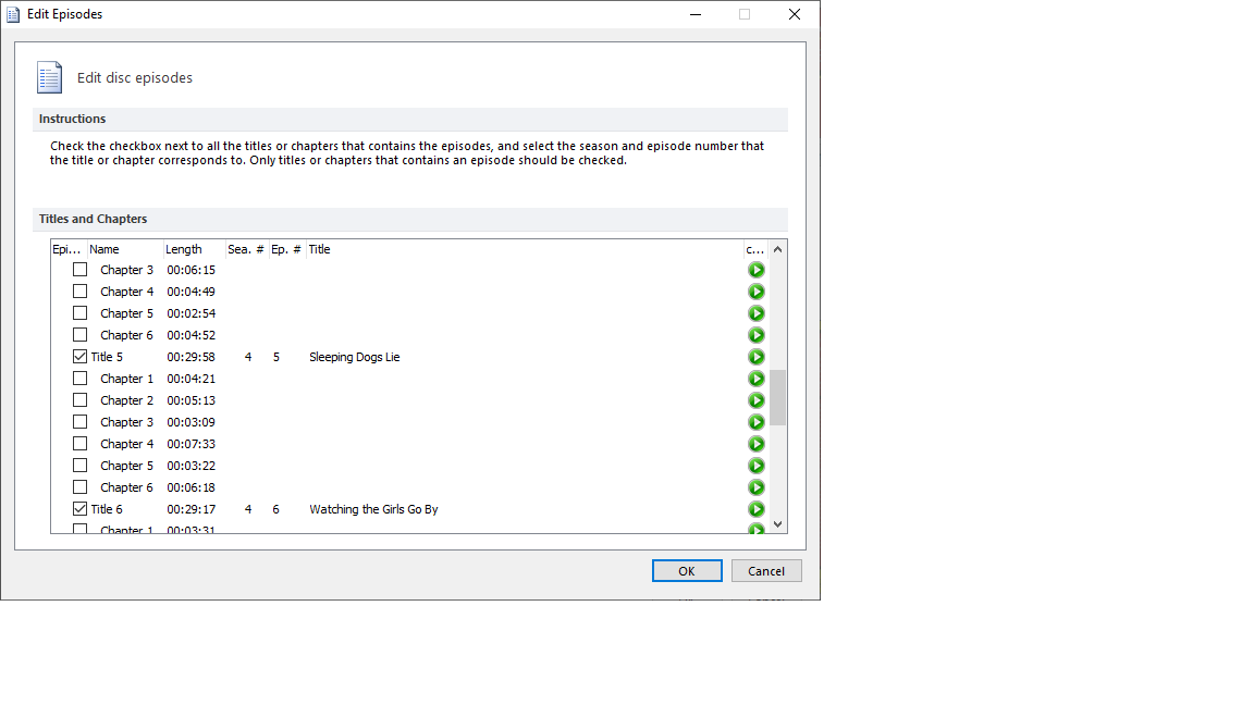

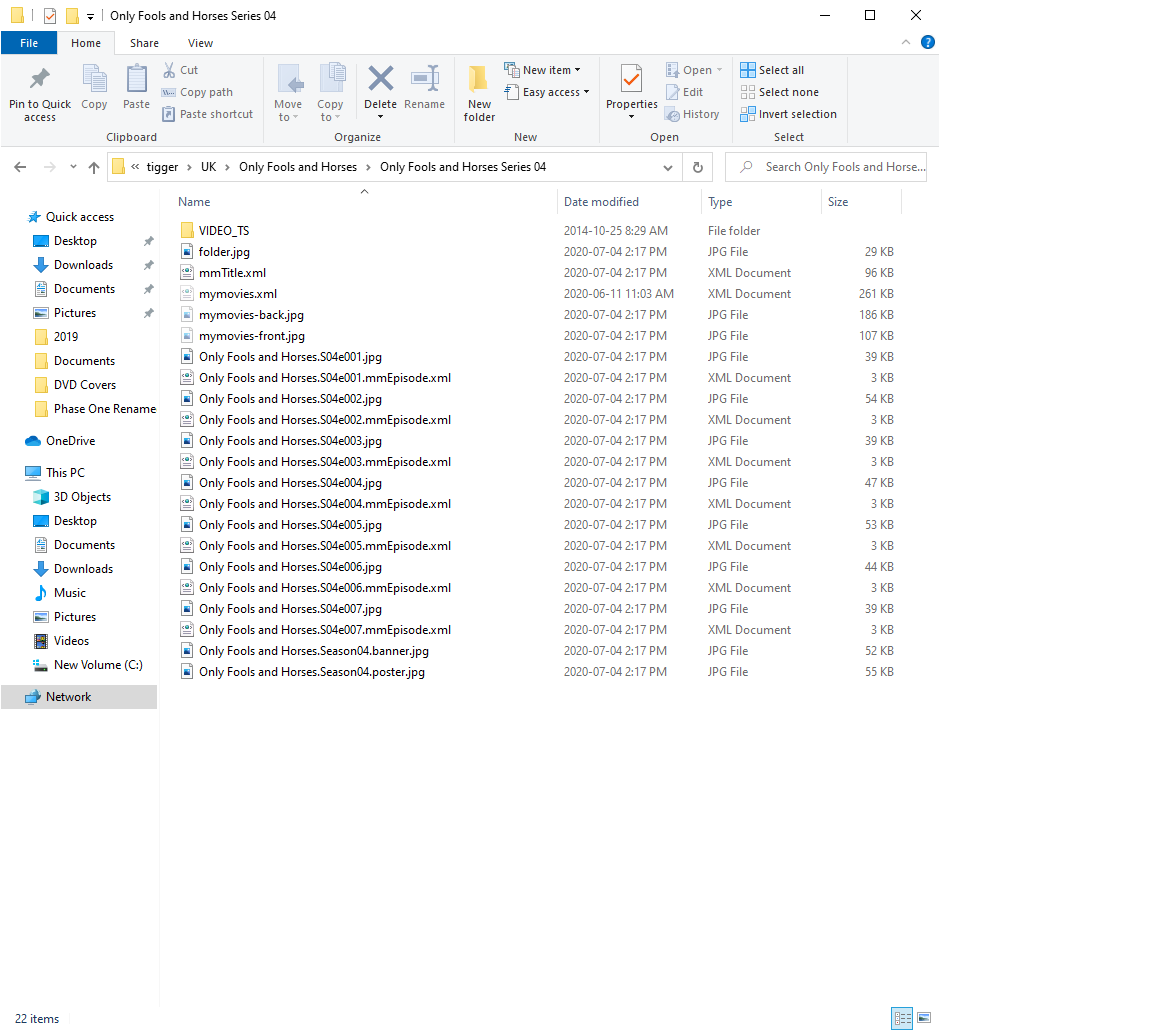

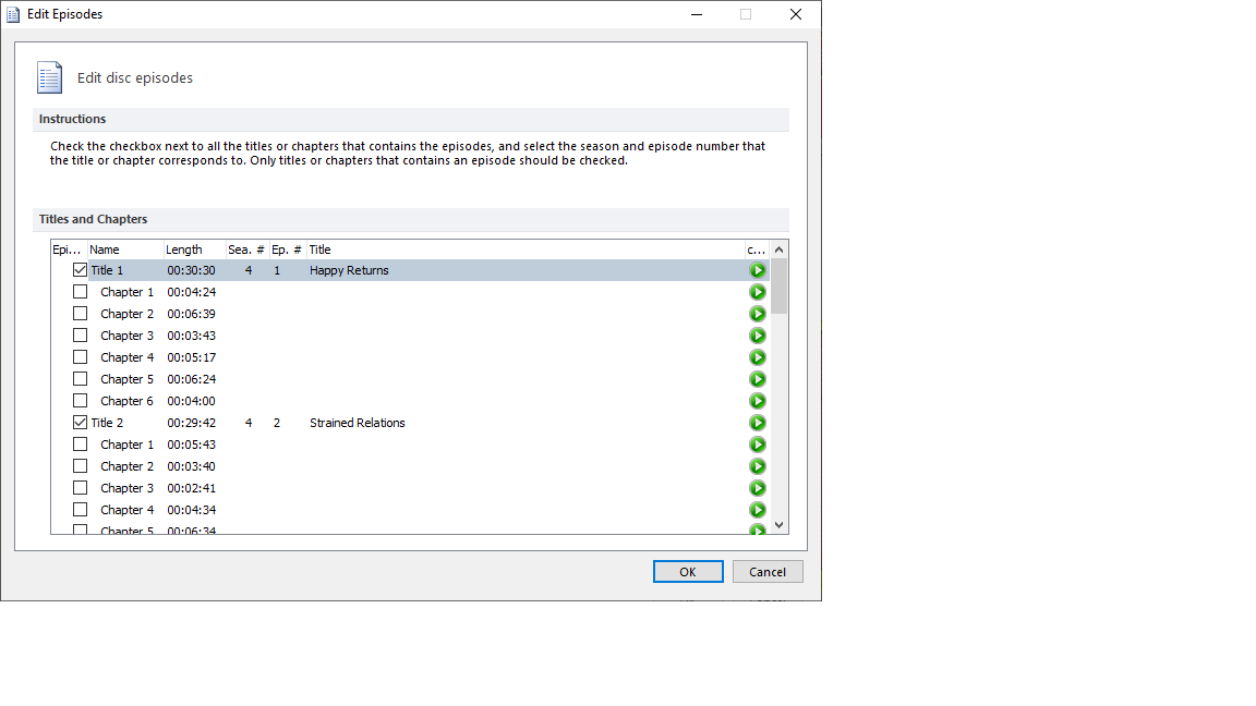

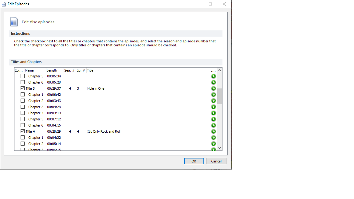

Sure
- S04 map 1.png (33.39 KiB) Viewed 17189 times
- S04 map 2.png (33.33 KiB) Viewed 17189 times
- S04 map 3.png (33.43 KiB) Viewed 17189 times
- S04 map 4.png (32.78 KiB) Viewed 17189 times
- Only Fools and Horses.S04e001.mmEpisode.xml
- (2.4 KiB) Downloaded 799 times
- Only Fools and Horses.S04e002.mmEpisode.xml
- (2.37 KiB) Downloaded 768 times
- Only Fools and Horses.S04e003.mmEpisode.xml
- (2.33 KiB) Downloaded 785 times
- Only Fools and Horses.S04e004.mmEpisode.xml
- (2.41 KiB) Downloaded 757 times
- Only Fools and Horses.S04e005.mmEpisode.xml
- (2.46 KiB) Downloaded 792 times
- Only Fools and Horses.S04e006.mmEpisode.xml
- (2.34 KiB) Downloaded 808 times

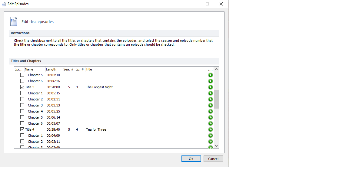

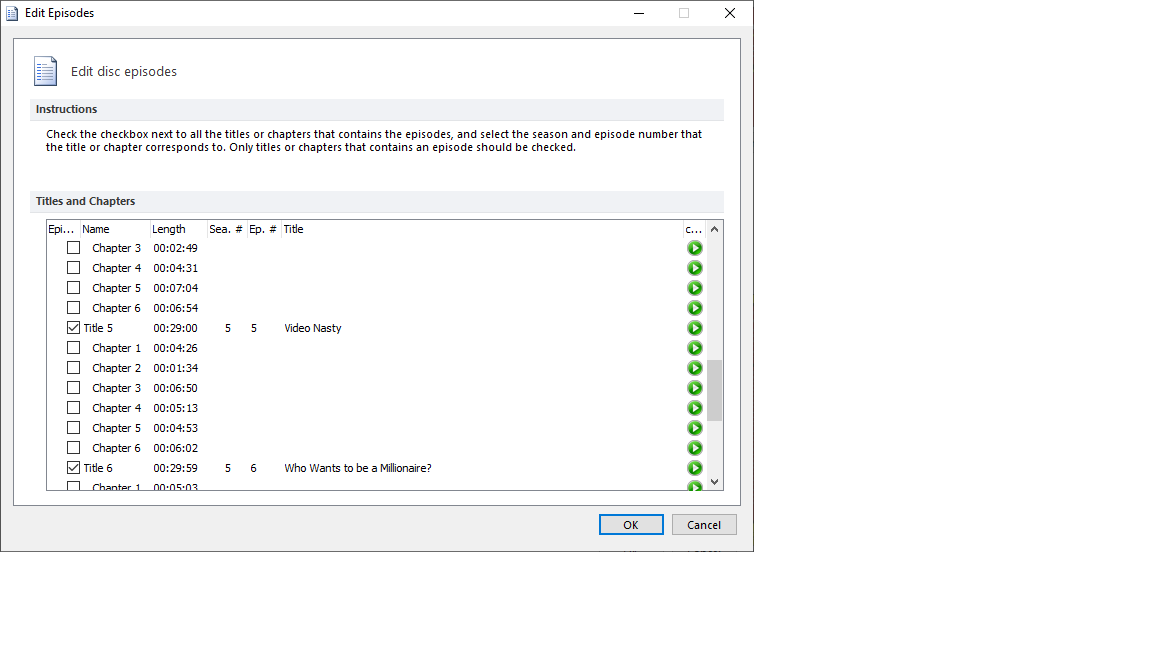

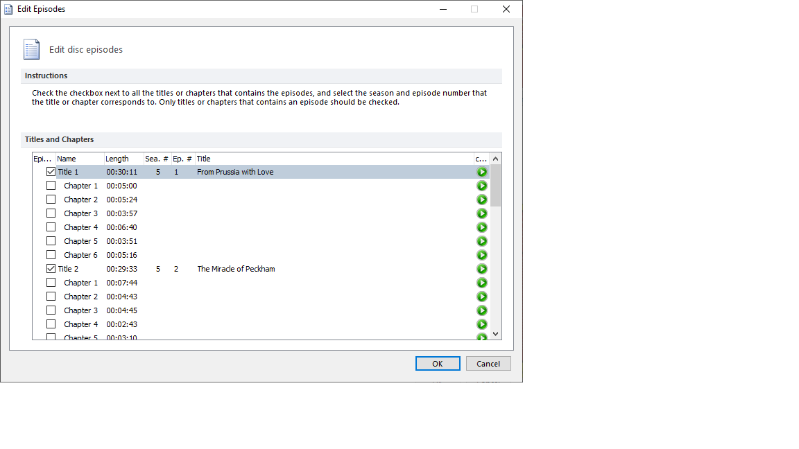

But Also I was having trouble with S05 so.....here are those maps and xml
- Only Fools and Horses.S05e001.mmEpisode.xml
- (2.52 KiB) Downloaded 814 times
- Only Fools and Horses.S05e002.mmEpisode.xml
- (2.4 KiB) Downloaded 766 times
- Only Fools and Horses.S05e003.mmEpisode.xml
- (2.4 KiB) Downloaded 759 times
- Only Fools and Horses.S05e004.mmEpisode.xml
- (2.53 KiB) Downloaded 799 times
- Only Fools and Horses.S05e005.mmEpisode.xml
- (2.58 KiB) Downloaded 791 times
- Only Fools and Horses.S05e006.mmEpisode.xml
- (2.37 KiB) Downloaded 734 times
- S05 map 1.png (33.6 KiB) Viewed 17188 times
- S05 map 2.png (33.07 KiB) Viewed 17188 times
- S05 map 3.png (33.45 KiB) Viewed 17188 times
