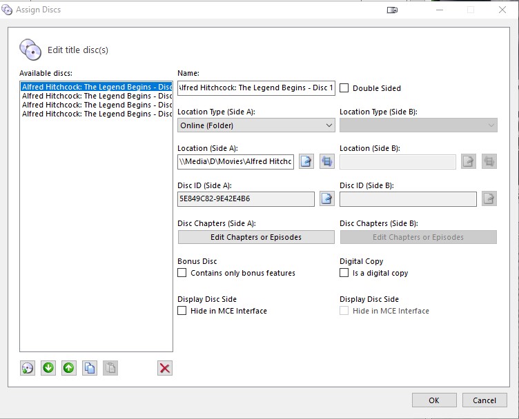

Here's the screenshot of the "Discs" for the Alfred Hitchcock - The Legend Begins.

Thanks Tom.
What is your goal for how you want to display Juno and the Paycheck? I'll provide some valid options to make this easier:
1) Alfred Hitchcock - The Legend Begins shows as a single movie in your cover rows. Selecting it opens the movie details (FanArt) page. Selecting Play prompts for the disc (i.e. Alfred Hitchcock - The Legend Begins - Disc 1), and you want Juno and the Paycheck to show as one of the Select Disc options.
2) Alfred Hitchcock - The Legend Begins shows as a single movie in your cover rows. Selecting it opens the box set, showing all the covers assigned to that box set. Juno and the Paycheck will show as one of the movie covers you can select, open the details for, and play.
3) Alfred Hitchcock - The Legend Begins: Juno and the Paycheck shows as a separate movie in your main cover rows. Selecting it opens the movie details for Juno and the Paycheck, ditto for playing it.
